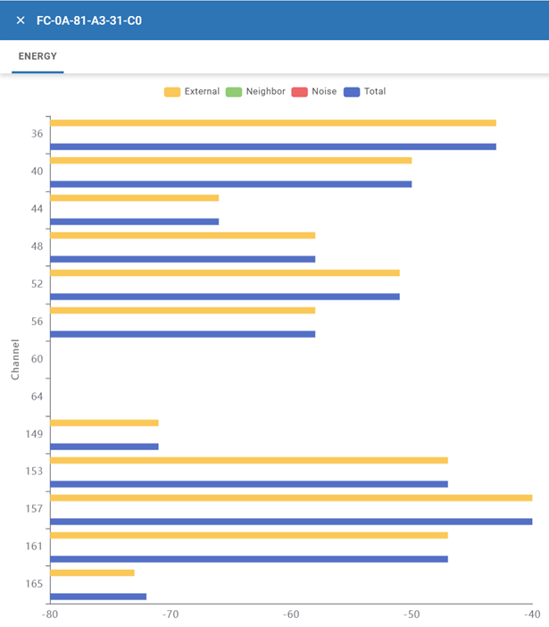

You can select an AP's corresponding Radio MAC address to open an Energy graph depicting .

If a RF Domain member radio's operational state is normal (use show smart-rf ap command on CLI), you can select the radio's MAC Address to open an Energy graph, as shown in Smart RF Statistics - Example Energy Display. The Smart RF Energy graph displays the selected radio's operating channels, noise level and neighbor count. Use this information to assess whether Smart RF neighbor recovery is needed with respect to poorly performing radios.
